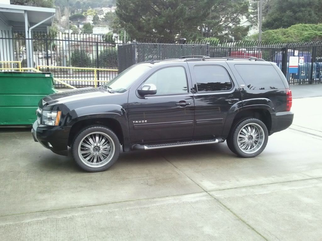

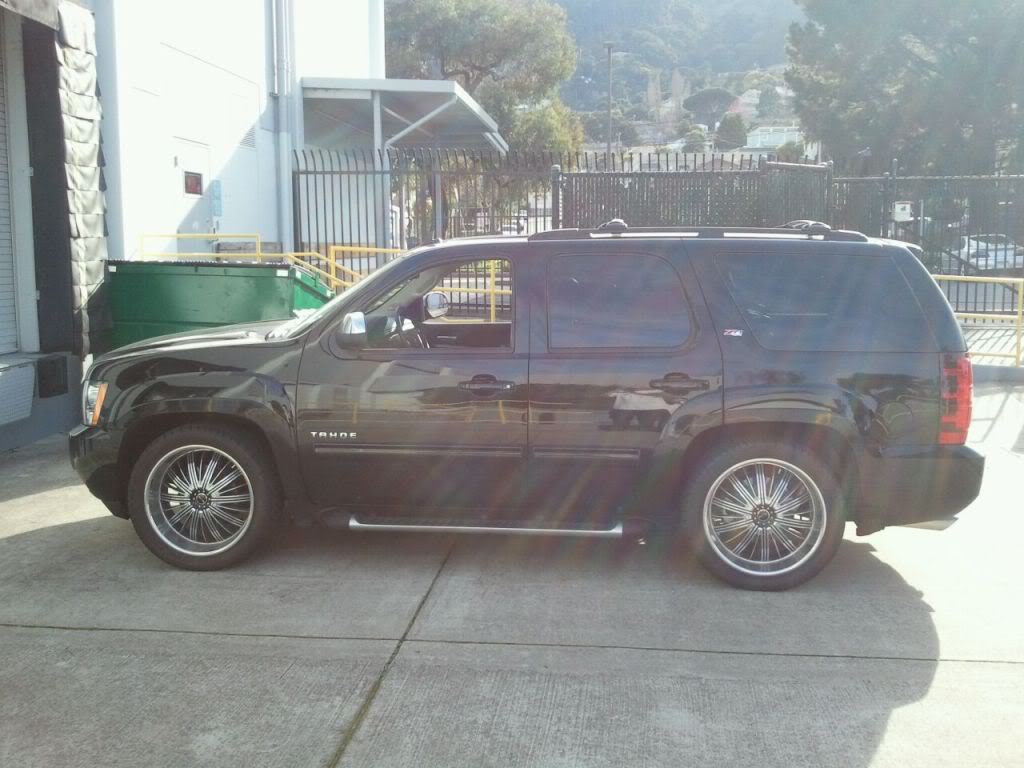

Another 2/3-4 07 up truck. Before/after pics
NORCAL SS
SUV SUSPENSION GURU
Jun 9, 2009
8,744
610
Just finished this truck
Kit used
http://www.tbssowners.com/store/index.php?act=viewProd&productId=87
also added were the rear belltech street performance shocks
Truck 2011 Z71 TAHOE
Tires
305 40 22
Before Measurements
RIGHT FRONT 36 1/8
RIGHT REAR 38 5/8
LEFT FRONT 35 7/8
LEFT REAR 38 1/8
After Measurements
RIGHT FRONT 33 7/8
RIGHT REAR 34.5
LEFT FRONT 33 3/4
LEFT REAR 34

looks great! i cannot wait to get my drop!.. how does that kit ride compared to the kit u have with the rear spacer and front struts?

I need to cut the bumpstops more in the rear i just cant because right now it hits the aftermarket exhaust so the shop will need to rebend that portion.
The rear kit is the same ie springs with the 1 inch spacer and drop struts
for the front went with spindles since its a new truck new struts arent needed
