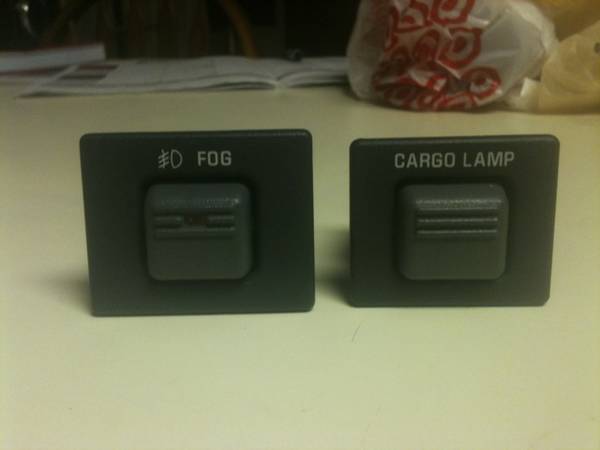

Looking at the switch on ebay, I thought that it would be the same size as the rear hatch release/cargo lamp switch that sits in the middle slot of the vertical cluster. However when I got it, I realized that is wider and taller than those switches. I have a cargo lamp switch Ill post a pic of as well for comparison

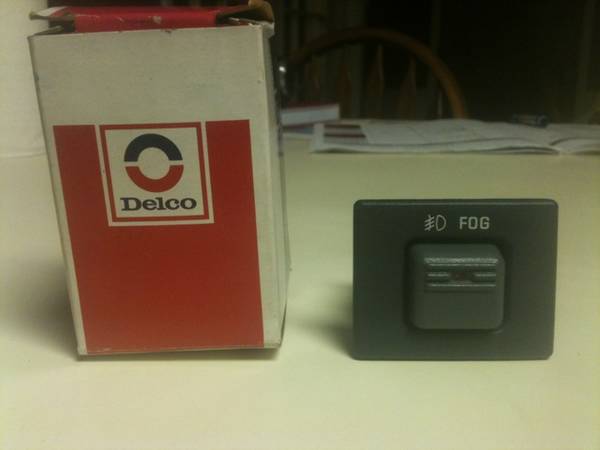

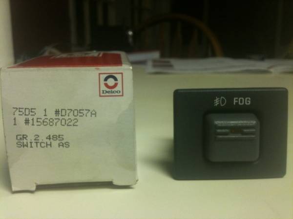

Here are some pics of the horizontal mount fog switch. Note the size compared to the cargo lamp switch. Its similar but the width is keeps it from fitting in the cargo lamp/rear hatch switch hole.

Found this info when seaching the P/N(15738877) that appears on my vertical fog light switch.
15687022 Fog Light Switch with indicator, lower 2x bezel
Horizontal style, large surround
12064762 – original PN Connector for 15687022
15687023 Cargo Lamp switch, no indicator, upper 3x bezel
middle position, small surround
12129136 connector for 15687023
15687025 Rear Hatch switch, no indicator, upper 3x bezel
middle position, small surround, momentary
12129136 connector for 15687025
15742071 DRL Off switch, no light, upper 3x bezel
end position, large surround
15305888 Connector pigtail for DRL Off switch
15687026 Rear Wiper Switch with delay and washer, upper
3x bezel, end position, large surround
12101833 Connector for 15687026
12110844 Terminals for 15687026 & others pk/10
15696254 Upper bezel, 3 openings, keyed, top & bottom larger
15696252 Upper bezel, 2 openings, bottom pos blocked
15694888 Upper Bezel, one opening at bottom
15694884 Upper Bezel, no openings
15696260 Lower Bezel, 1 opening
15696258 Lower Bezel, no openings
15738877 MY 98 – 2000 Fog Light rocker
