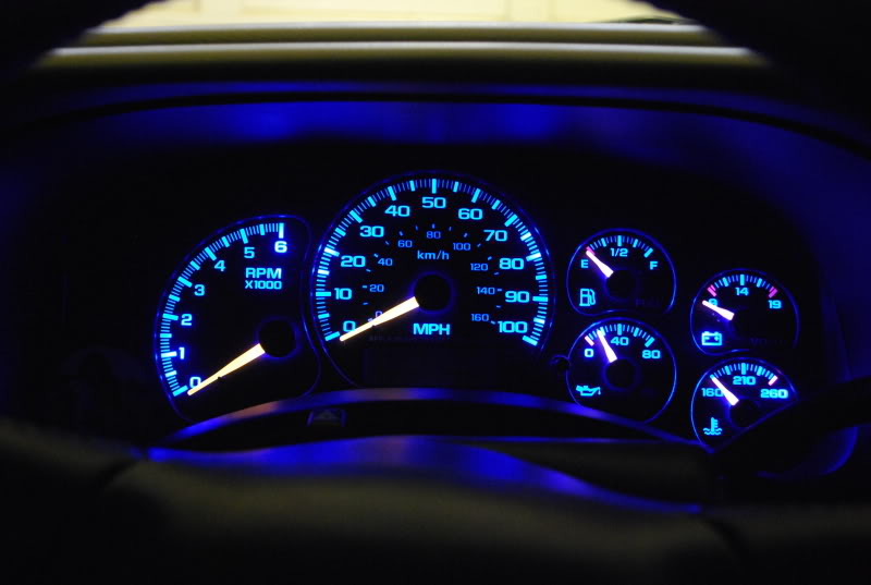

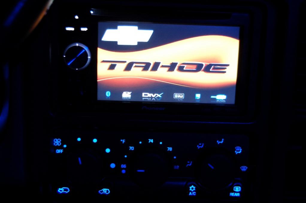

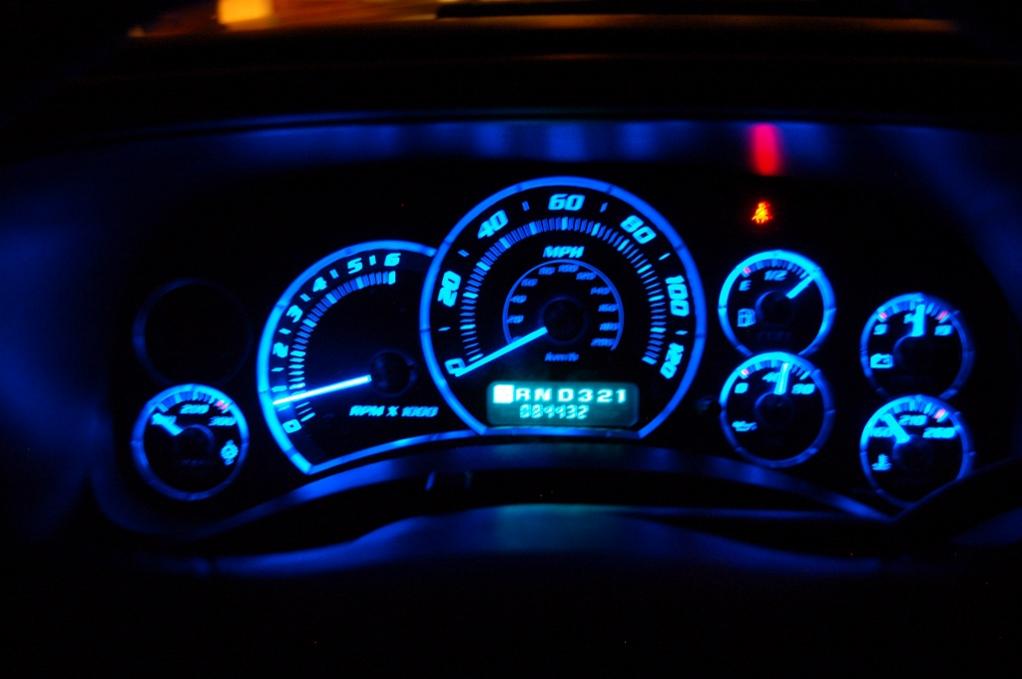

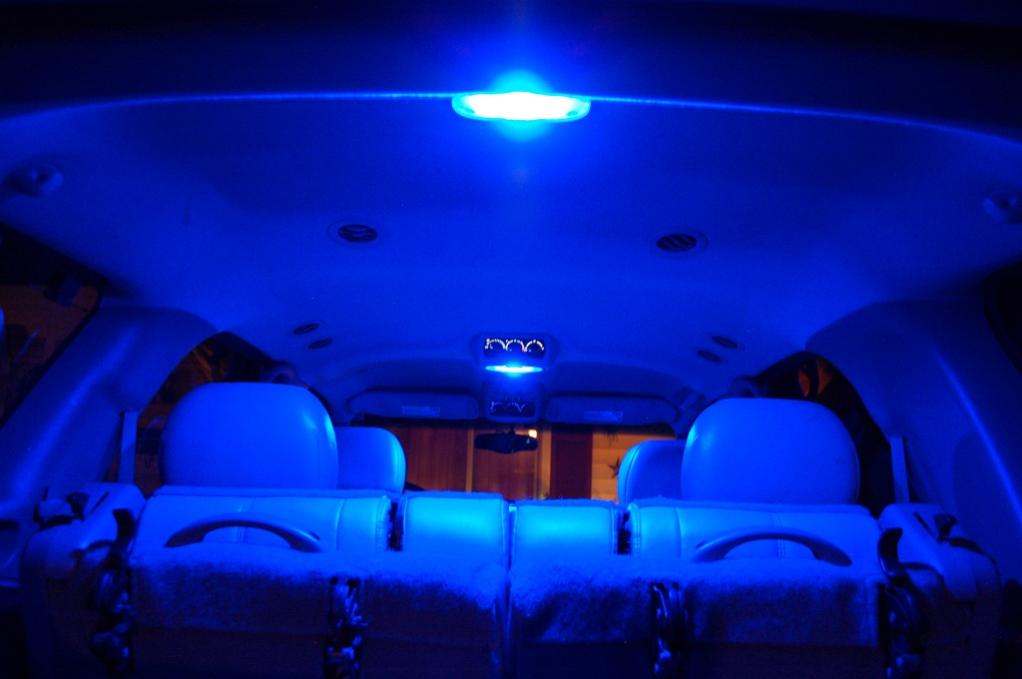

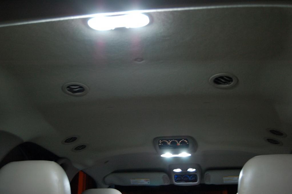

Same done here with the thanks of many people on here for the ideas .. attached are images showing what I have done to my '02 Tahoe.
First image : 02 Escalade Cluster with Blue 194 LED's
Second image : HVAC LED installation using Blue LED's 5mm 6000mcd Wide Angle w/ 470-ohm 1/2w resistors (Notice also the double-din installation of a Pioneer AVIC-F700BT)
Third image : Ultra Blue 42mm Festoons installed for main lighting (194's in doors and floor)
Fourth image : Ultra White 42mm Festoons installed for Reading and front Map Lights .. also installed into Puddle Lights.
Heads up in regards to the LED installations for HVAC and other areas .. I played around with a few resistors in regards to finding the right ones to use .. originally started with 4.87K-ohm 1/4w, found that the LED's were to dim .. tried 470-ohm 1/4w, made a huge difference from the first ones I tried, much more brighter, but a little limited .. settled with the 470-ohm 1/2w, this proved to be the best where I did not need to modify anything else in regards to sticking chrome tape all over the place to direct the LED's.
