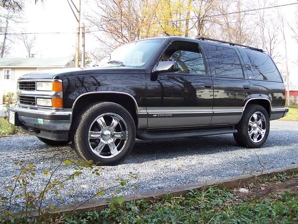

Here is a picture and video of my 99 Chevy ***** 120000 mi
Click the link for the video - its louder on the vid than in real time
