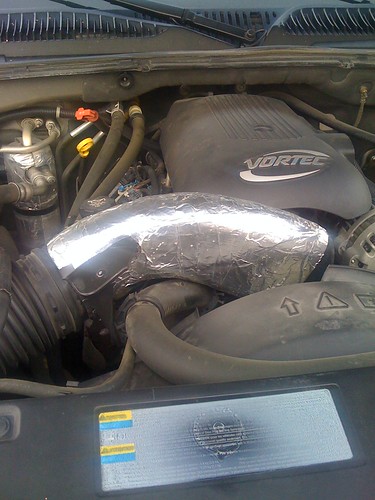

I made this one

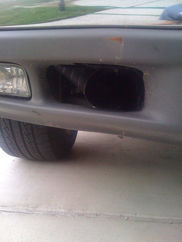

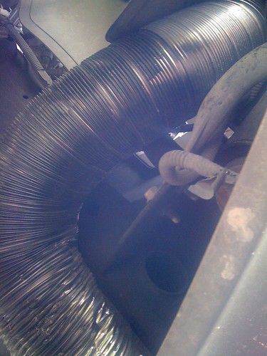

With an electric hot knife i cut away the baffling then finished it smooth with a dremel. I had some 1/16" ABS sheeting from another project so I cut it to fit the openings left behind, heated it up and molded it to the contour of the intake then melted it into the intake. Because I do not trust my plastic welding skills, I also wrapped it all up in HVAC foil tape.
Next I cut out a 6" hole in the bottom of the air box and ran a clothes dryer duct from the box to the opening in the air dam.
Painted the ducting flat black so it did not stick out like a sore thumb and secured it to the air dam with a big fender washer so it would not rip it out.
IAT's at 129 degrees on a 103 degree day in Texas before the CAI. After the CAI on a 104 degree day, 98 degrees. On the very next tank of gas I went from 13.4MPG to 15.2, and have been holding steady ever since.

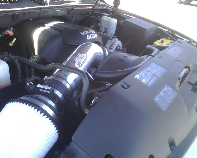

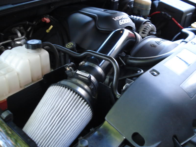

I took my aem brute force, sanded the tube down, and painted black to match the truck
