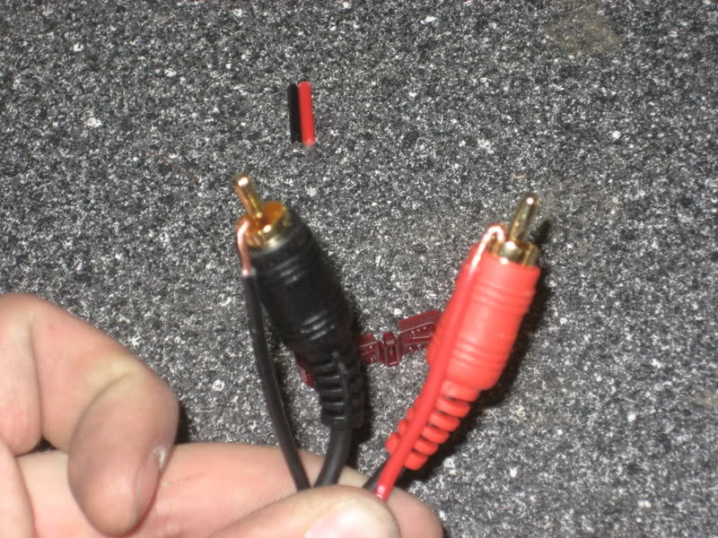

try this... take the radio out and use the ground from the radio to the rca shield.. if that gets rid of the noise then the pico(sp) fuse is bad on the radio...
