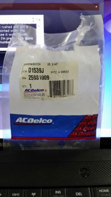

I have the same intermittent problem of the cruise control. I made sure there were no codes in any module on my truck using the Tech 2 scanner. Then I rushed and got a new switch and changed it in 5 minutes or less. I was very disappointed when the control didn't work :shocked:. All the people in this thread were happy because it worked with them immediately :gathering:. I don't know why it didn't work for me although I'm pretty sure there are no codes present. The part I installed is brand new. The ACD number is D1539J.
GM number is 25981009. Its picture is in the attachments. Could anyone help?
