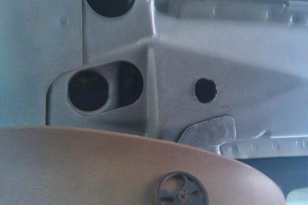

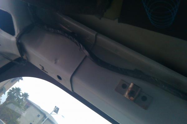

The roof rack receptacles are hidden behind some steel.
Here in the back,
And here in the front,

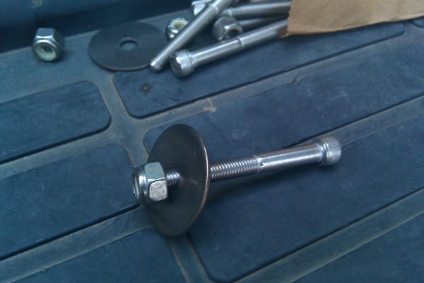

The old receptacles were broken free so I just pulled those out the top. To be replaced with these,
Different lengths of 1/4 in socket head bolts, fender washers and nylon locking nuts.

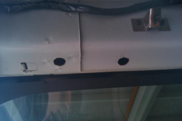

To gain access to thread the washer and nut onto the bolt. Holes had to be drilled through the steel.
In the back, the hole on the left(back) was already there but had to be filed open to allow a 7/16 socket. the other had to be drilled. I stuck the bolts through from the roof. Placed the washers over the new holes with some serious finger ******* and using long skinny tools(a file) to push them around.
I put the 7/16 nut into the socket and on the end of an extension. I pushed the socket through the hole and balanced the washer on it as I pressed them onto the bolt threads. This required patience.
The front, the hole on the right(front) was there, unfortunately those were the only receptacles not to break. The other hole had to be drilled and filled open to allow a socket. The front was significantly easier than the back as I could use my skinny ass fingers to put the washers on the bolts and then the socket and extension to install the nut.
