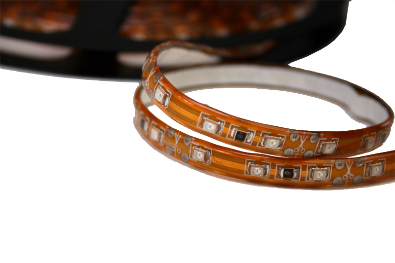

This is not a LED light bar like you see on every other pick up on the road, this is waterproof LED ribbon light that's flexible so you can mount it wherever. The LED bar that goes on picks ups will not work on Tahoes because of the curve it has in the rear bumper. I got it from oznium.com

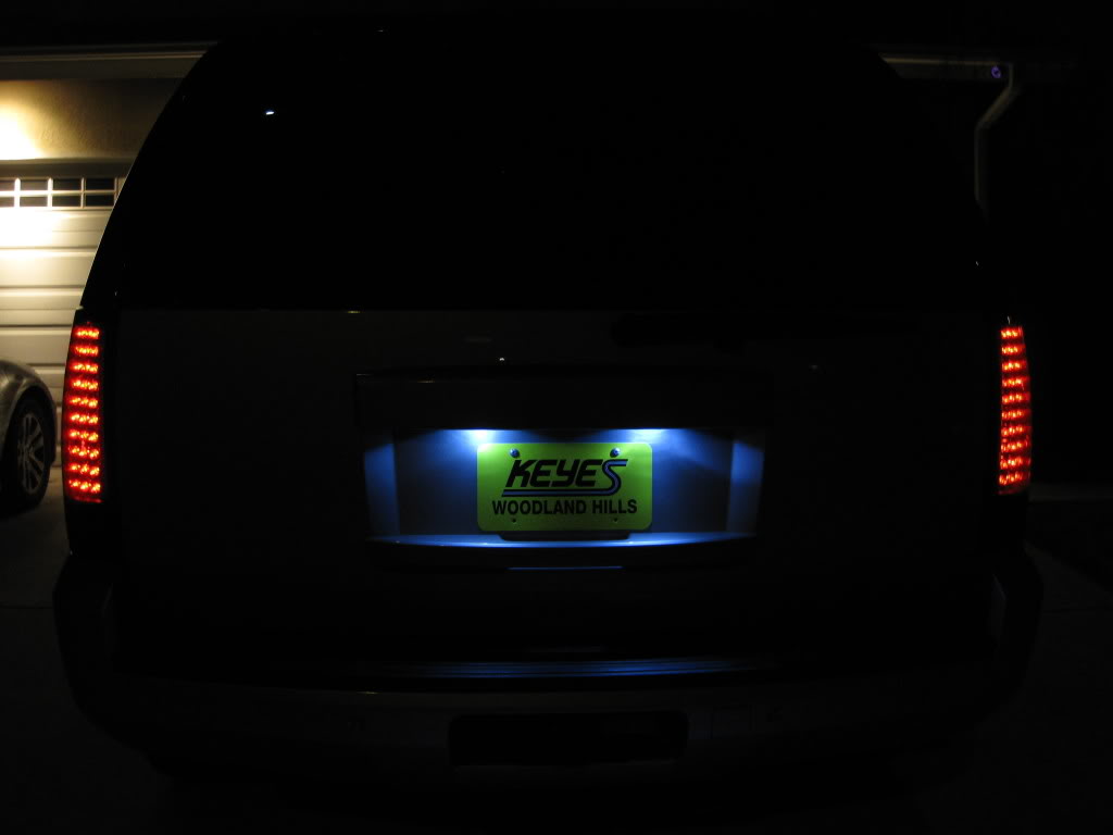

Looks good DWDrummer, in reply to Nfamous60 here is a pic of my LED tail lights blacked out. They are REALLY REALLY BRIGHT! even during the day...check out the pics.
This is just the running lights, when on the brake times teh lgith by 3 no exageration!

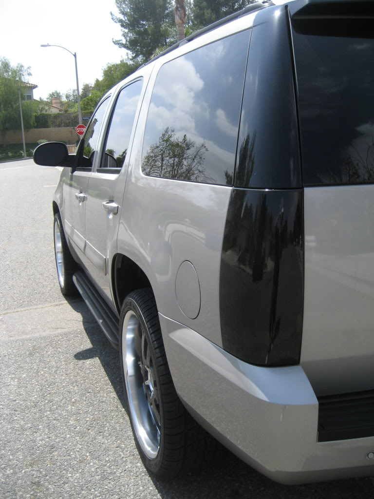

looks great.i also used vht to tint mine but i need to take them off and polish them out a lil better.what steps did you take to do the polishing.

Did you clear coat your lights? After the clear completely dried I water sanded with 2000 untill it was completely smooth and look like they were flat black. Then I buffed them out 2-3 times with rubbing compound with my porter cable set on speed 4-4.5 Then I used some Adams Swirl and Haze remover to hide any little swirl or scratches, then used some wax to seal them off:Handshake:
