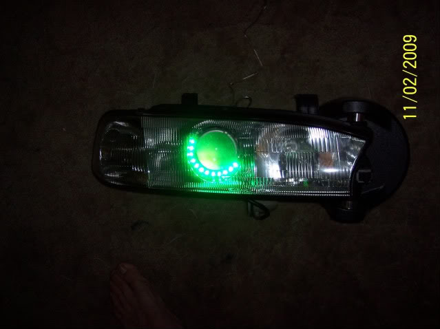

Here's what my friend did. He did these for a customer...he has his own side-business customizing lights...he painted the shields green, but also added some green LED's in a half-halo. These are not Tahoe or Yukon lights, but you'll get the idea:

Denaliak, that green looks cool.
