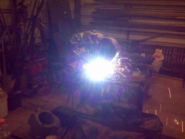

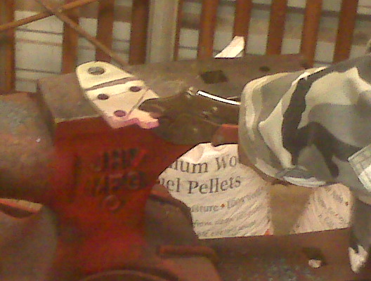

For a while now, alot of us have been looking for a dual-stabilizer with not much luck....so since my single seemed a little due for changing the shock out, I used this as an excuse to build my own dual stabilizer with some flat stock metal. It was a good bonding experience with my brother-in-law who's a cool cat, and I learned how to manipulate metal pretty well.
Hot out of the acetylene torch oven :signs6:
Don't look into the light!

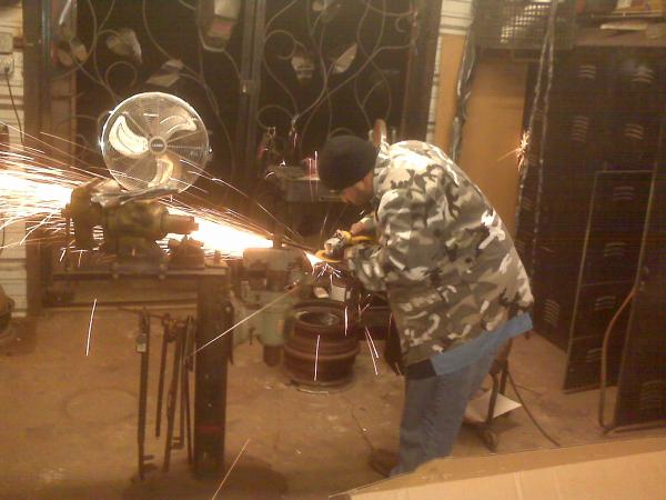

Grinding em smooth

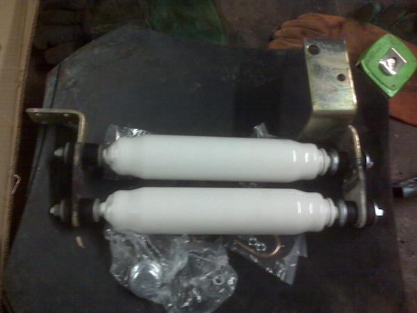

Raw

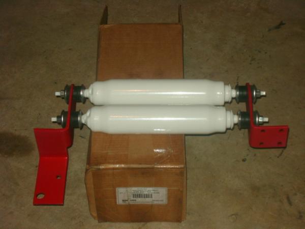

After we got them nice and square and flat, I primed em good and painted them that Eibach red :Handshake:
