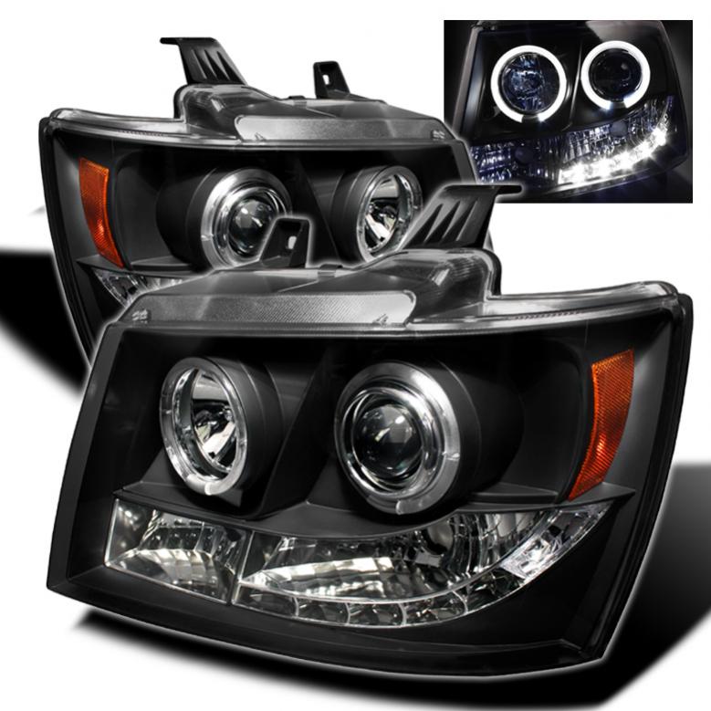

These are the lights...

Someone else has those headlights on this forum but I don't think they put HID's in them. Some after market headlights are not made to work with HID's... these might be some of them... like other guy said.. try to put in stock bulb with the headlights and see if the problem still persists.

I have those headlights along with another member on here, you need to space the bulb out of the housing roughly 5/8 inch. , since HID's light from the center of the tube and are much longer than the H1 halogen bulbs that come with them. I was able to get a much better cutoff and beam pattern, but spent alot of time with bulb placement, just fyi there is a sticker on the housing that specifically states not for use with HID bulbs.

Really.... I must have missed the warning. I did just go to the Spyder Auto site and see that: "These projector headlights are not compatible with factory Xenon H.I.D. system, it comes with its own standard Halogen light bulbs for installation." Funny that the retail sites don't post that info.
