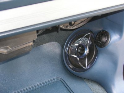

yea, you need to glass or dampen the qforms to make them more rigid. Here are the ones i had in my '88 SWB.
