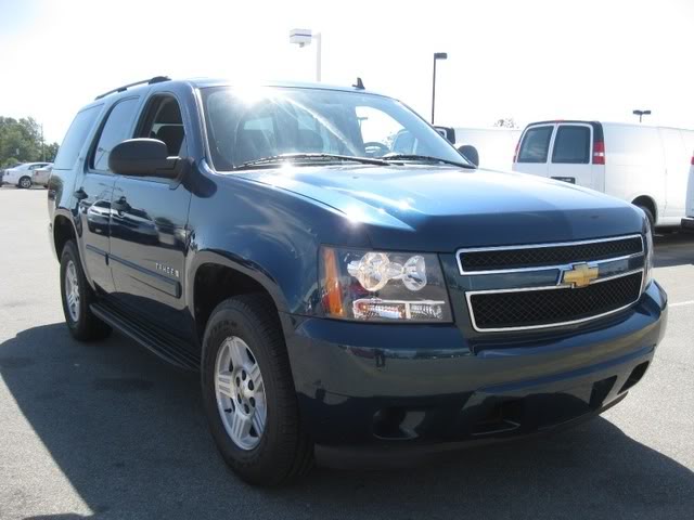

Thanks! The chrome is the trim around the front grille. Here is what it looks like stock (this pic isn't my tahoe):

oh. ok. not what i was thinking, but looks really good now. I never did like that chrome on them. just looks off to me.
