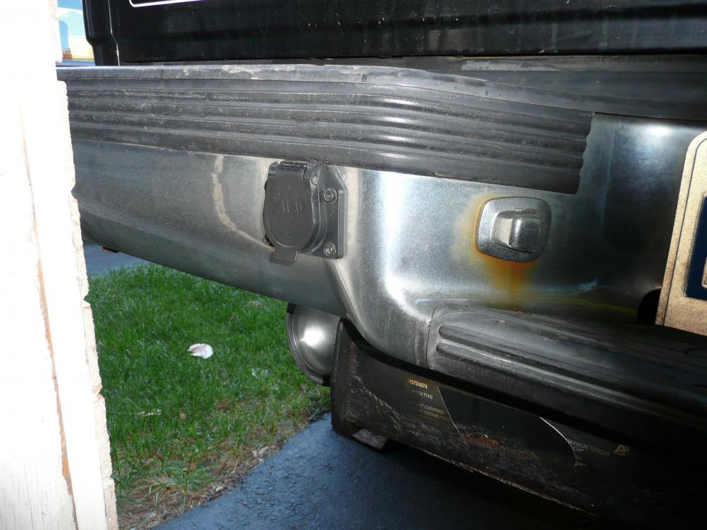

- The trailer wiring (truck side) was a red neck job, so i cleaned it all up with harnesses etc and tucked it into the rear bumper for a professional look.

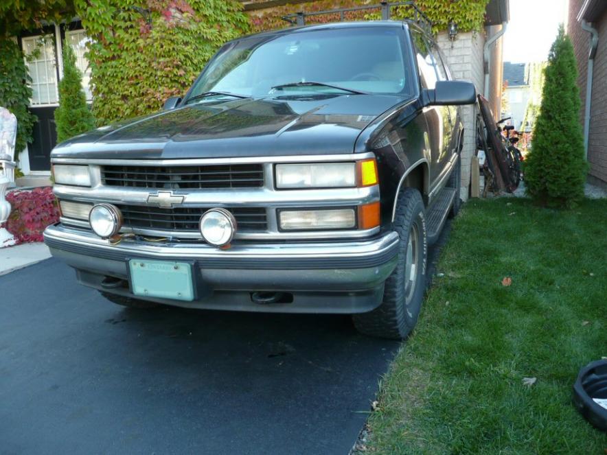

- The lights are a miserable failure in these trucks. So i added drive fogs/lights up front and while i was at it added two more for the rear for camping/unloading/hitch work in the dark etc. I am a night driver, especially when i am towing and now can see more of the road (and occasional wild life). I located the switches in the center console so that I did not have to move my arm too much to turn 'em On and Off.

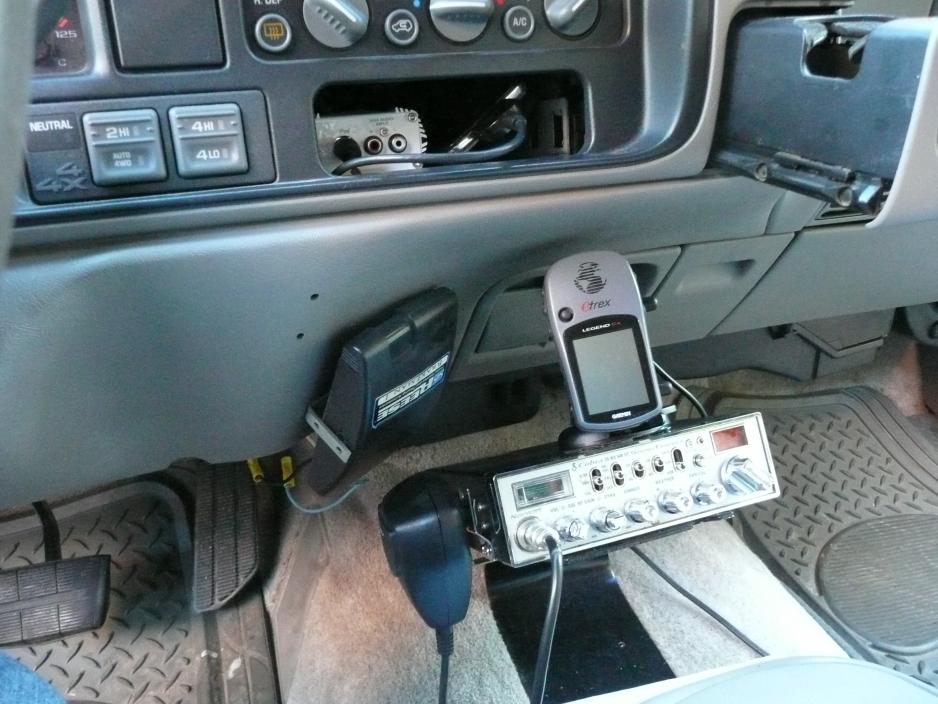

- Given the towing and time spent on the pavement, I added a Cobra 29 WXNSST CB Radio. On a clear night I speak to US truckers (I live on the Canadian side of Lake Ontario). A plus again to get to know another language. The CB lingo is strange! I mounted the unit in front of the OBS Centre console (see Pic). At this moment, I use a magnetic antenna but hope to make it permanent on the roof rack, in the future

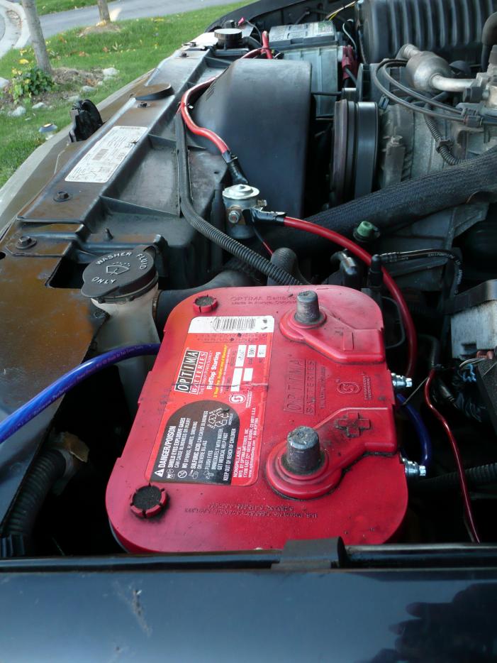

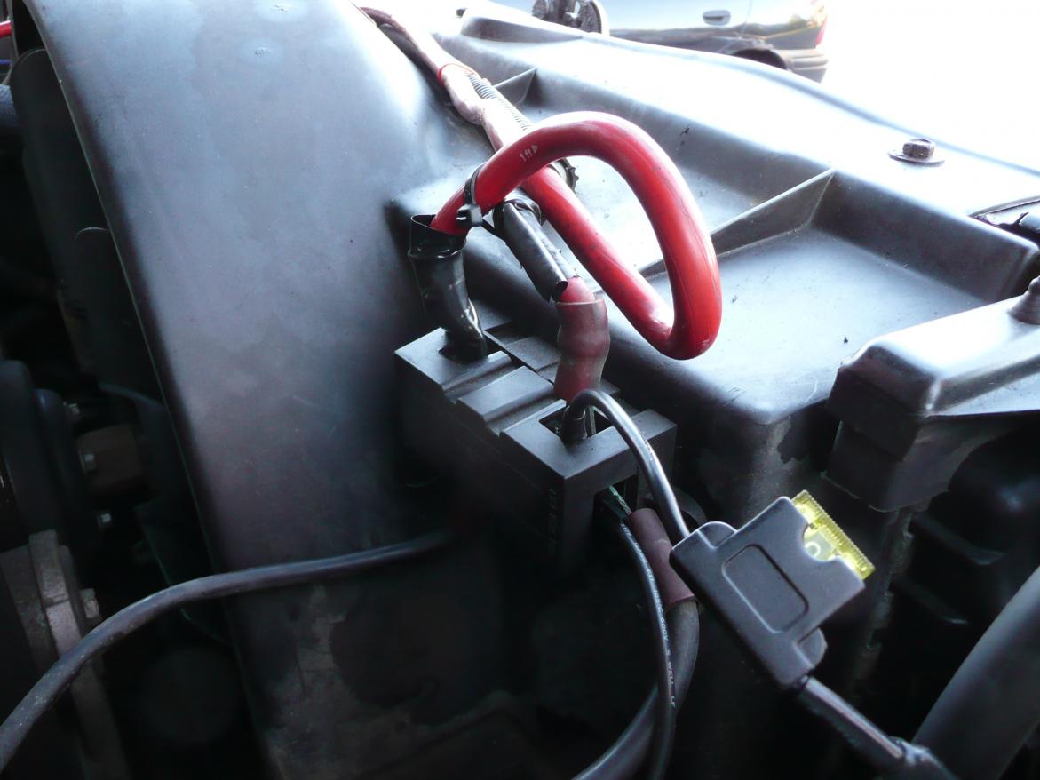

- All these extras require battery power, I found that the hard way when I left a door slightly ajar over night. So I added a dual battery setup to mitigate that error. This write up helped me immensely and I Thank all the authors. I went with Gauge 4 wire from a Hi Fi shop / Solenoid (I have used these for winches before) from the RV section / and a Optima Red top as the aux battery. Cheap and cheerful it has held up so far.

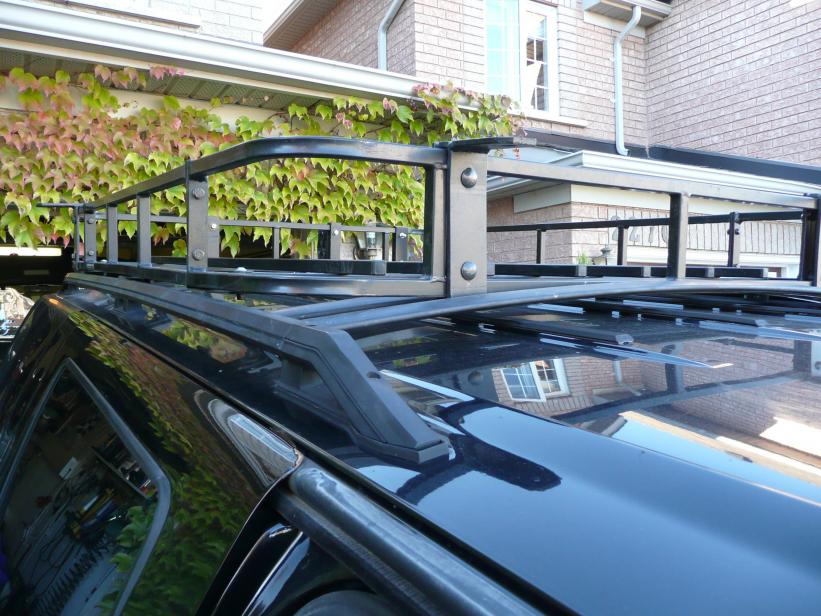

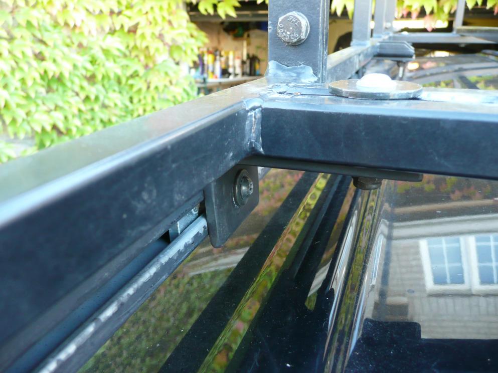

- I had bought a Garvin Safari Hood Rack for my Jeep but never got round to adding it as I could not have got it in the garage. So the other day I put it all together and tried it on the Tahoe. I did not have the brackets to attaché said rack to the Tahoe factory railing. Garvin wanted my new born for a set. So I put my metal working skills to the test n came up with the brackets and viola the rack is now on the Tahoe. Comments are welcome. I do have 5 light points, 1 CB antenna point, shovel/axe bracket and the Hi-lift bracket. When all these things are on it should look good. Mounting lights will take some time (I don’t have any spare lying around), but when the others are done I will post some pics.

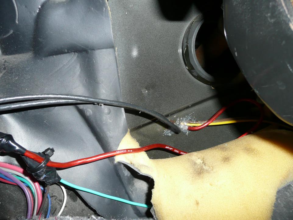

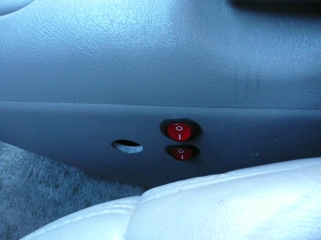

- Dual battery setup
- where i routed the wires into the cabin

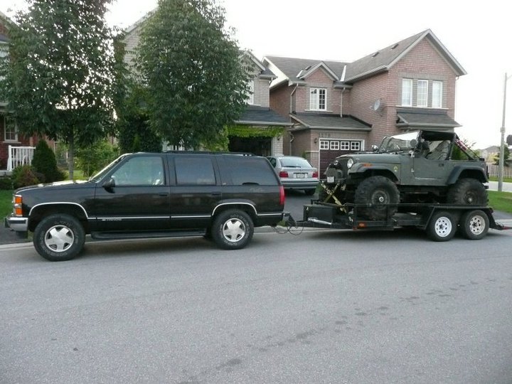

- Rear hitch cleanup and lights
- Hoe as it stands now
- The rear holding up with the extra leaf (those are 285/75/16 on stock rims)

I like the roof rack! Good job on the fabricating the mounts!

CB folks: How/through where do you route the antenna cable out of the cab? Right now i have it through the door edge but don't think it is a good idea permenantly.

I run a General Lee (same as the Connex HP) and a permanent mount antenna (Wilson 1000). Antenna hole is drilled just forward of the last cross brace in the roof (~18" forward of CHMSL) and the coax runs between the roof and headliner to the passenger A-pillar, through the dash to the center console.
Since you're running a magnetic mount, your options are limited with the coax run. Prior to running the permanent mount, I ran my coax out the passenger door and zip-tied it to roof rack.

- After a dead battery situation (thanks to the dual battery setup i was not stranded), the primary battery was found to be dead and apparently was running on the aux, so hoping to swap it to a marine battery that i found for cheap $$
