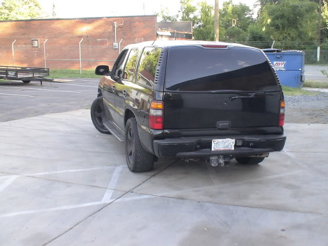

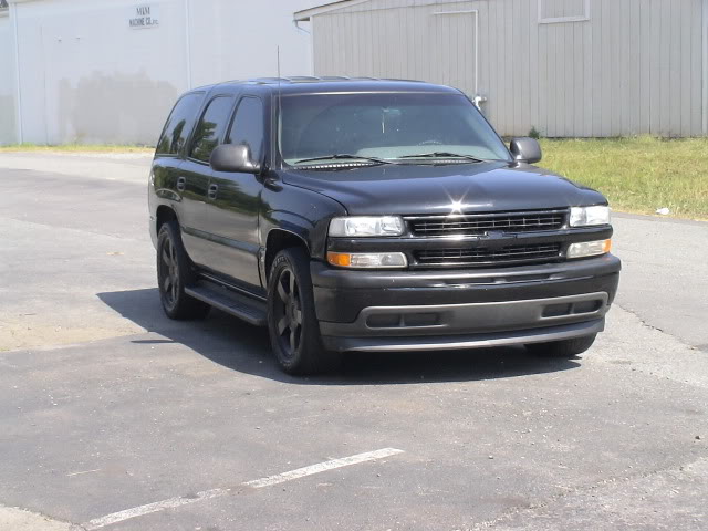

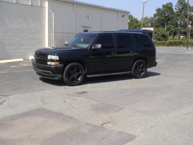

ok, I bought the DJM kit, and bolted it up with easy, just takes some common sense. I have to admit, I installed the shock extender wrong at 1st and could only get 1" drop out of my kit. Got researching and pictures always pointed the extender down, so I made some changes, removed the isolators, and now I got my arse down 3.5" in the rear!
I decided to use the stock keys upfront, as my truck is a stock 2wd, and had crazy rake when I got it. So Im actually ONLY 3 turns down from the stock 2wd height. Rides like butter. Im surprise how well it rides and handles, and I take some serious turns, and it just hugs the road so well.
This is the real deal
The drop was economical and did wonders for my truck, looks tons more sportier. Tony was a big help as well, as I picked at his brain.
Now I have a BEFORE the drop pics. looks like a sky scraper
Came along long ways

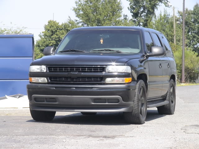

Yes, stock keys.
Its the stock keys, decranked 3 turns. I still have my djm keys in the plastic wrap. I get the extra .5 inch in rear from removing the isolators. Tony was great, This drop is economical and looks outstanding. Minded I have a 2wd.
:Handshake:
---------- Post added at 10:46 PM ---------- Previous post was at 10:39 PM ----------
1 more from that group, this is what 2% tint looks like.
---------- Post added at 11:28 PM ---------- Previous post was at 10:46 PM ----------
also I plan to decrank another 1/2 turn. This will compensate, for the isolators which are removed for the .5 in the rear. I think Ill be dead perfect then. About the valence I will get to it soon. Real soon. :)
