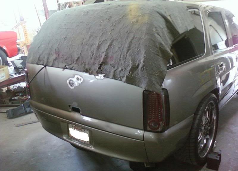

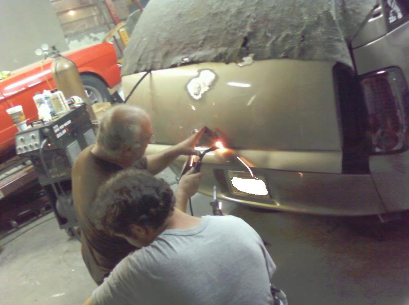

im no welder and dont know much about it at all... so this may seem like a dumb questions, BUT....
i thought the lift gates on these trucks were aluminum... does that require a different kind of welding?

Looks like a MIG welder to me.

idno if the gates are aluminum it seems pretty solid whatever it is, but i dont weld either, thats why my friends dad is doing the welding lol, but the welds work fine we didnt run into any problems
DESIGN
May 16, 2009
47
North Texas
Pretty sure that only the newer hybrids have Aluminum hoods and rear gates. Ours are stamped steel.
Well, I stand corrected. I just went and put a magnet on the lift gate and no pull so I guess they are Aluminum. Learn something every day.
However, you only have to swich the gas and the wire on a mig to weld aluminum.
