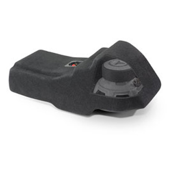

Anyone run one of these?

It's a sealed JL 10W3v3-4 - 500 watts that hides in the console. Obviously I don't know audio, but need more bass than the 03' Bose is giving. I have a 500 watt amp. They say it replaces the factory sub/amp. I like the concelled/stock look, but wonder if it will be enough of a difference?

yeah thats gonna thump a lot more than the stock bose. for sure. its not gonna beat 4 15s in a wall. but youll notice it :)

I don't personally have one, but I have put quite a few of them in in my installer days. You will notice a huge improvement in sound quality over the stock Bose sub. The install on this box is not hard, but it is incredibly time consuming and a LOT of disassembly. Be prepared to cut a lot of plastic out of the inside of the console and drill two holes in the transmission hump for the mounting points on the box. You will also need to drill out the rivets that hold the factory sub in place on the console.
The best advice I give for someone putting one of these in is to follow the directions EXACTLY because if the holes are drilled in the wrong spot on the transmission hump the console will not go back in correctly. Also make sure that you cut the inner plastic out correctly with an airsaw (or something similar) because again the console will not go in correctly if you miss something.
The first time I did one of these it was almost four straight hours of cussing and throwing stuff because it can be very frustrating to put in, but once you get it in there it's well worth it.

The rear air vent issue is only on the Silverado/Sierra. If you were to put a sub in the rear quarter area of an 03-06 some modification would need to be done to the panel for the best sound because the "grill" in the back is not perforated since they moved the factory sub to the console. You would not hear hardly any difference if you replaced the Bose sub with a JL six. It's possible there would be depth issues with that also.

Thanks for that input. I have a JL Stealthbox in my Grand Cherokee and it is indeed a great addition. your note about the rear vent issue makes me think that the JL is going to be the way to go.

I wonder if that jl box would work well for added midbass to an existing system instead of adding additional midbass to the doors...?!?! hmmm...very pricey i'm sure instead of just putting a second midbass in the door though...hmmm...
