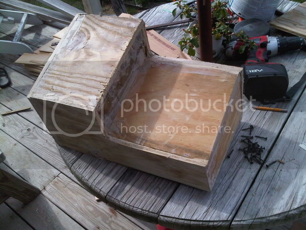

i was able to fit the 8w7 back there although i had to fab up a new box which was extreamly tricky i will post pics later im just running wires currently

the 8 inch w7 fits in comfortably and hits with a 500 jl amp

for an 8w7 i would have used 3/4"-1" mdf and braced the $hit outta it, not your plywood or whatever that is, i hope you checkee for leaks, and used bracing and tons of caulk etc, just my opinon....
+1 on the MDF!
