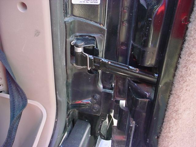

The part you need is a check strap. The GM part number is 15048810. I also included a photo of the part.
List price from GM is $29.75

If the check strap is not broken in half then it has to be replaced. If not then you just take some channel locks and bend the piece of the check strap that wraps around the pin in the door tighter to the pin. After time the pin wears down so the check strap is no longer making contact with it. Quick and easy fix.
