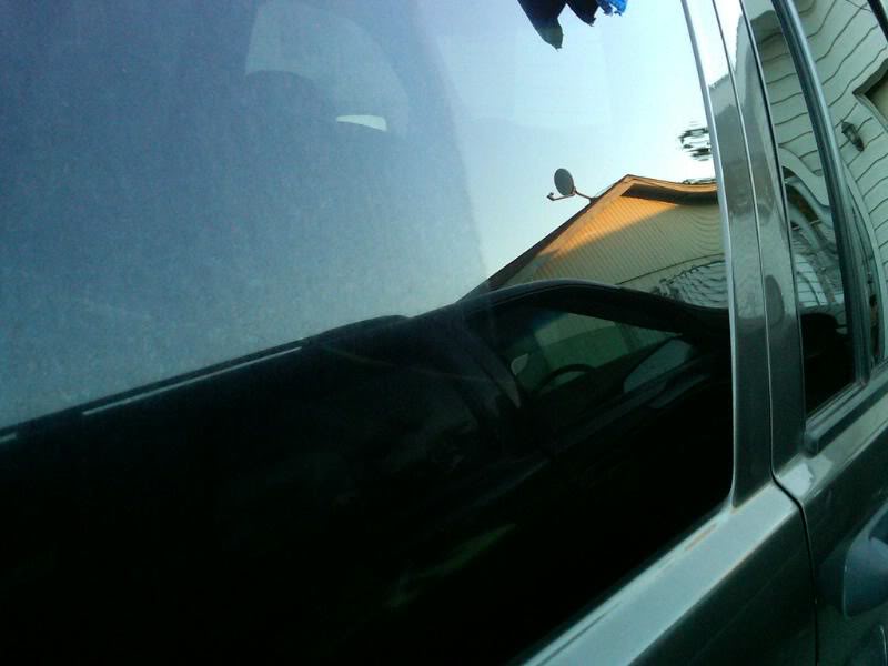

I used turtle wax rubbing compound and some fine steel wool. It worked really good but took a good half hour on each window. I also have muriatic acid and thats muchhhhh faster but extremely dangerous if you don't know what you are doing. I'll post a pic asap> ok so I tried to upload a pic and failed.. so if somebody can help me out ill send you the pic and I can go figure this out
---------- Post added at 11:37 PM ---------- Previous post was at 10:31 PM ----------
118413[/ATTACH]"]http://
lets see if that worked
