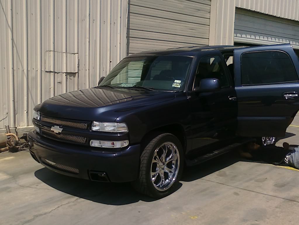

No pics of them yet. I just got it back from paint on Friday. I still need to do a few things to it, but here is a picture I got with my phone. I'll probably try to get some more as soon as I install the drop and exhaust.

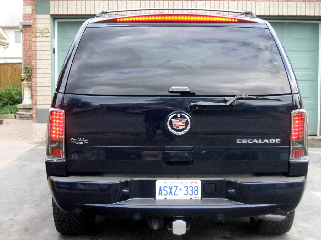

I have a small problem with mine...
No fast blink or anything during the day... But at night when all the lights turn on, I get a fast blink when signaling and braking at the same time. (pretty much at any street corner) Looks like the signal light, brake lights and marker lights are competing for the same bank of LEDS, causing a fast blink... I'm not sure if my tails have any jumpers to solve this..
here are mine:
