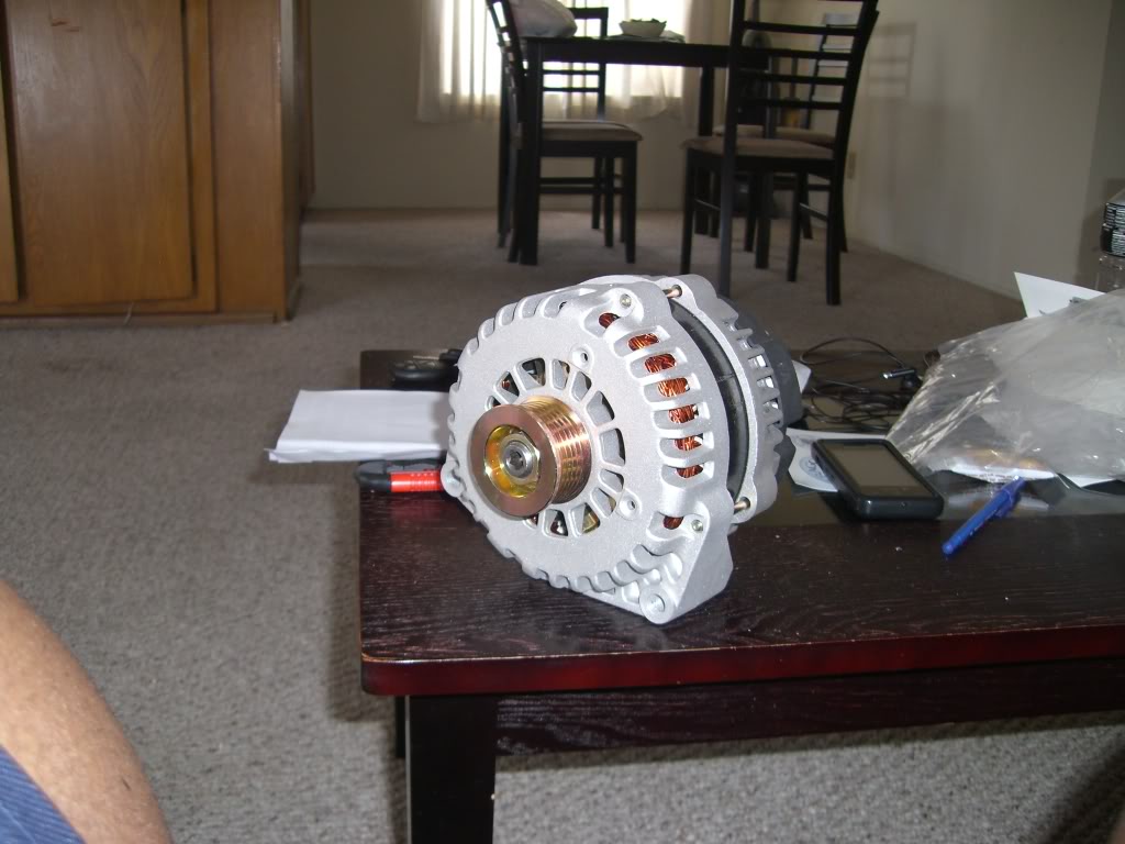

This will probably be my only tech write up I do because it deals with electronics. Anyways, my electrical system could not hold the necessary voltage so I decided to upgrade my alt.
Iraggi 300 amp alt
OEM on the left/new alt on right
Pic of serpentine belt lay out
Pic of the Serpentine belt tensioner on the far left
Alternator bracket
New Alternator installed
tools used were a 15mm/10mm/5/8" socket
- 15mm for depressing the belt tensioner.
- 5/8" for removing the mounting bolts
- 10mm for removing the positive nut on the alt.
From start to finish, the swap out took an hour and that included running to autozone to pick up a socket and I am a novice. When/if/even if you don't upgrade your alternator, it is recomended that you upgrade your charging leads(Big 3)(the red 0 gauge wires you see) if you run a heavy electrical load.

Yes, I see a huge difference with the new alt. Before with the stock alt, I did not have the current to charge my batteries and play my system at 3/4 volume. Now I can play at full volume and not see my volt meter drop.
The only caveat to the alt is its the lower grade series and while I see more amps at idle than my stock alt, If i crank my system at idle, my voltage will drop, but at 2k rpm, I stay at 14 volts.
