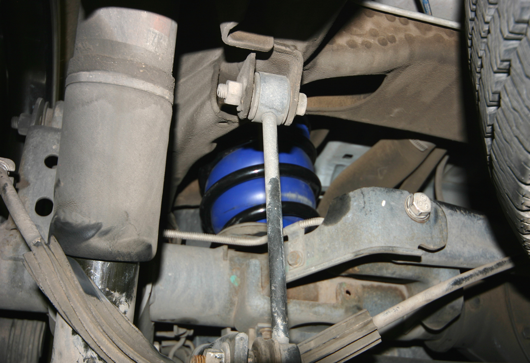

I recently purchased my '02 Yukon Denali and installed a 2/3 McGaughy's Deluxe drop kit but I noticed that my rear Auto Air Ride shocks were leaking and the compressor was turning on every 10 minutes and due to the 3" rear drop it would constantly bottom out (very annoying)
I priced out some Auto Air Shocks and it ranged from anywhere from $599.00 to $1200.00 (that's insane!)
That's when I looked into McGaughy's Air Helper Kit (approx. $150.00) the kit is basically an airbag that goes inside of the rear springs.

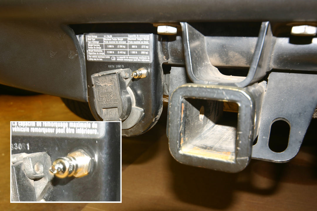

I have the air hose nozzle (included in the kit) located next to my hitch for easy access but I'm looking into having it hooked up to a compressor so I can lower or raise the PSI in the cab.
I highly recommend these! Very good bang for the buck and since the rear never goes lower than the Auto Air Ride sensor, it'll never turn on the compressor.
It'll be cool if somehow I could use the Auto Air Ride compressors for the Air Bag Helper Kit. If anyone has any ideas, please chime in.
If your Auto Air Ride is shot and needs replacement...we have an alternative to purchasing new Shocks. I'm pretty sure that this kit was designed for the McGaughy's rear springs but I'm sure there are some type of universal firestone airbags that'll fit the factory springs.
Hope this helps?
