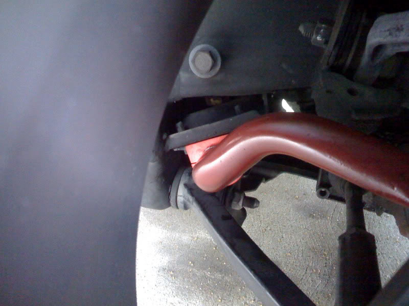

Installed the rear yesterday after work, took me all of 20 minutes in my driveway. Front looked a bit more involved so I dialed it up after work on my alignment rack. Spent maybe and hour, half of which consisted of me wandering around the shop looking for tools. The difference in weight alone was staggering, not to mention the size. Front is 35mm rear is 32mm, huge difference in handing. Front end turns much smoother, I can stand on it around corners and walk the ass out a bit now too. I may end up shortening the rear links but I'd like to bag it so I can get some measurements first. I can't believe how well it handles now.

Front came with new links, slightly shorter than my stockers. Rear uses the stock links but I swapped a set of JK wrangler rear links in place since they were a hair shorter and brand new off a truck I lifted. Sticks like glue now, I just twisted the shit out of it getting gas and it's not a sloppy ***** anymore.

They're larger and more rigid than the stock pieces. Dramatically improved the handling, truck is much more responsive and feels much more stable. The front bar weighed twice as much as my stock sway. Polyurethane bushings are always a bonus too. Raced some fool in an old body lightning and stomped his ass, always nice to know my suv is faster than a reg cab ford.

Eibach was the most economical for both front and rear. We carry hellwig, eibach, belltech, etc and the eibachs were the largest bars for the least amount of loot...only downside is the color but you can't see them anyway. The bars mainly help cornering and sway control.
