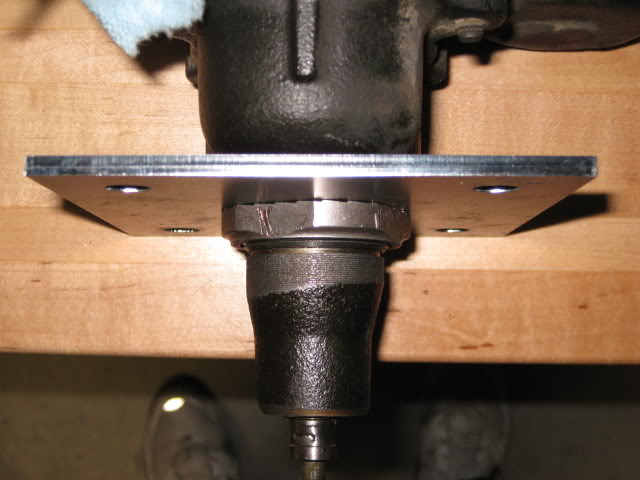

I took the snap ring off the unit and unscrewed the retaining nut with a big adjustable wrench and test fitted the new plate. All fit perfectly and the holes of the new plate matched the stock plate holes.
(I used this centered plate because I used the stock brake pedal).
I bought the plate from ebay from the seller sterlingworth16. It is 3/16" thick steel.
http://motors.shop.ebay.com/merchant/sterlingworth16_W0QQ_nkwZQQ_armrsZ1QQ_fromZ
Pic of the master cylinder.
I cut and threaded (3/8-16) the pushrod making it shorter by +- 5 mm. Once I get my vacumm booster off I'll measure and adjust the rod to the same length. The joining nut is stainless and 1-1/8" long. By doing this and using the center mounting plate, I can reuse my stock brake pedal.

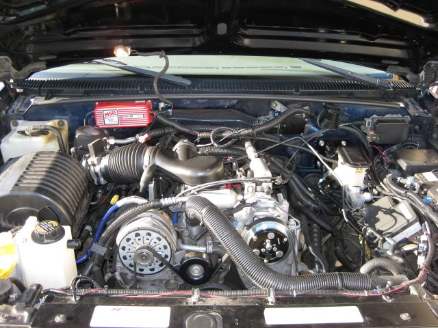

End result:
Hydratech hose and fitting kit for a 99 tahoe. These are Aeroquip TFE high pressure hose and fittings. Great service and packaging on hydratech's part.
Before
After
Filthy!
This setup has been on for about two week so far and has worked great. I actually had my first panic stop yesterday and was glad I did the swap.

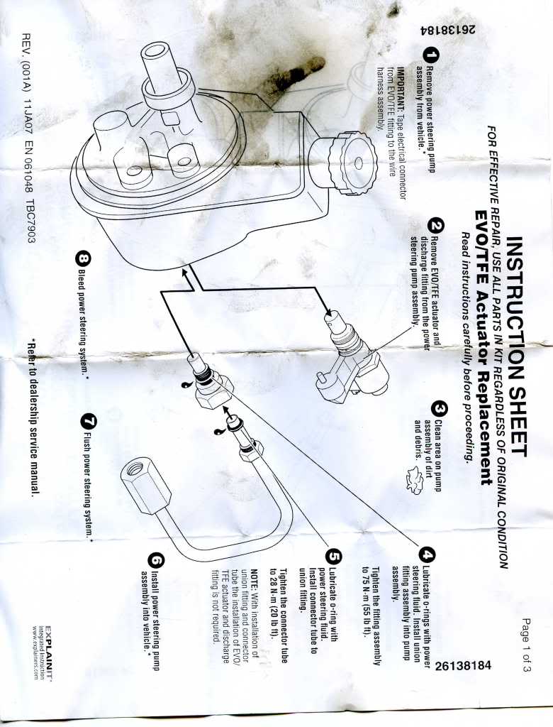

Only issue i have right now is that when I push the brakes while turning a little, there is a little jolt in the steering. Not sure if anyone else experiences this but I'm assuming it has something to do with the speed sensitive steering. I do not believe any hydroboost trucks have the variable assist steering so i think if you use a PS pump without the EVO valve on the back then you'll need a steering gear from a 96 truck.
One thing I'm going to try is to use GM's elimination kit for the variable assist steering and see if it cures my jolt.
http://www.pacificp.com/forum/viewtopic.php?t=10246
GM#19168825

definitely post your results....i found a few more articles and it seems that jolt is fairly common for hydroboost conversion on rigs with variable assist steering.
