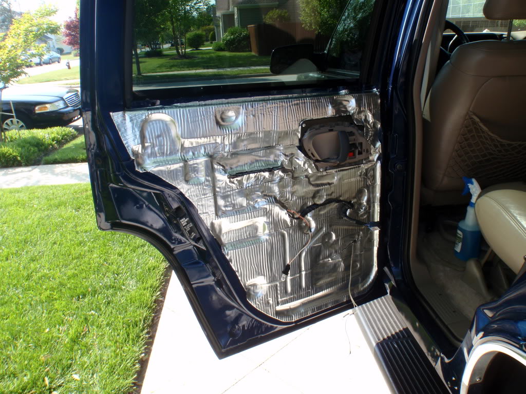

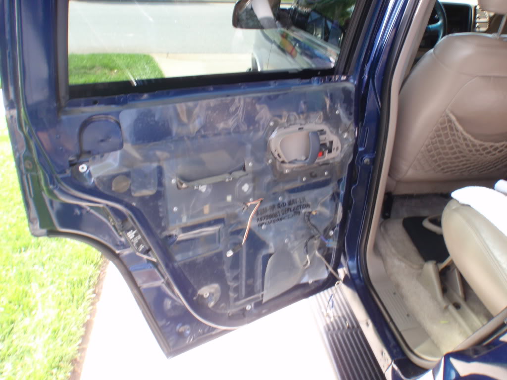

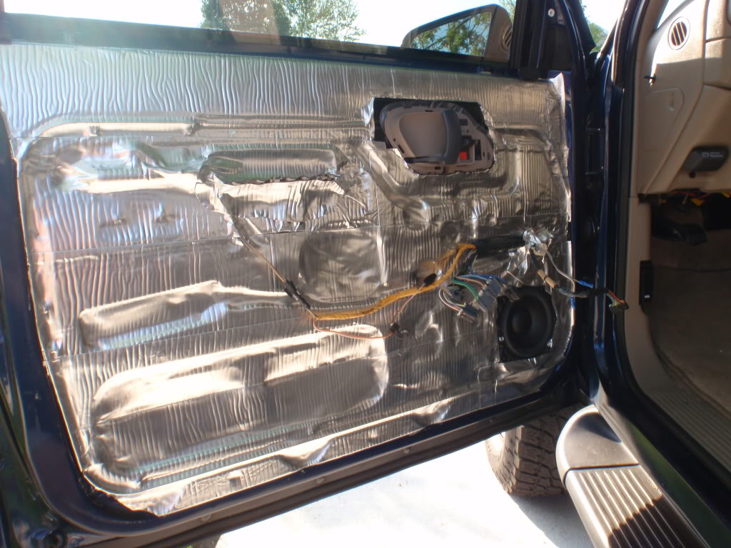

I got bored today and went to Lowes to get some peel n seal, but with no luck. I went to Home Depot and found some Quick roof (which is pretty much the same thing). For $16 for 6"x25' it beats any other sound deadening. My first concern was smell..and this had no smell at all. I already had some dynamat around my door speakers but i want to do the whole door. I used an ammonia based window cleaner to clean the doors, and this stuff sticks ALOT better then you think. The biggest thing is that you can work it 10 times better than dynamat. Dynamats aluminum tears very easy. With one roll I did my tailgate and passenger rear door with a little left over to start the front door. I still have to do the drivers side doors tomorrow and will post pics. This stuff is a little thinner than dynamat and it says its good up to 125 degrees....but if its behind your door panels they are pressed up against it and will hold it in place
