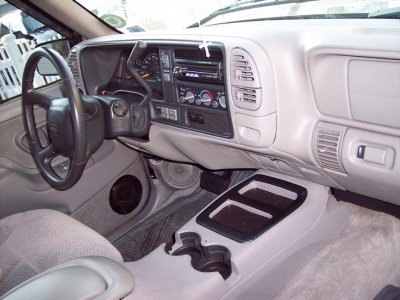

unclip the seat cover at the base of the seat and stick your hand up to the pivot point of the arm rest ,there is a spring clip that you have to remove and the arm rest will pull out. The escalade and denali in 99-00 have this console which fits nicely in my 2 door

clean and sexy interior man!~
thats my kind of interior man...nice and clean...dude where and how did you get that console...very interested and looks sick?

I would love to have one too. At junkyards, they're a needle in the haystack. You can find them on ebay but they're not cheap.
97yukon
Mar 9, 2010
263
baton rouge
i found a few on ebay around 250 but there trashed...i also can only find gray and i have blue interior...i have interior paint but that would be a paint in the ass....i have a piece that extends the console now...will prob just settle for that

i got it off ebay for 250 in great condition out of a denali and i have to say it was one of the best mods i've done to my hoe
