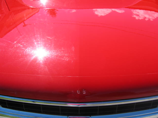

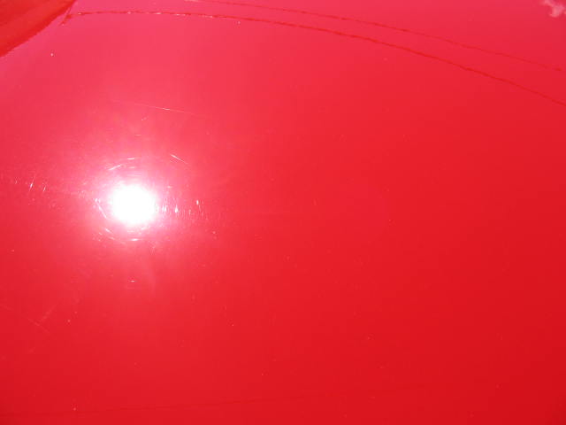

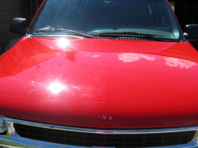

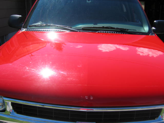

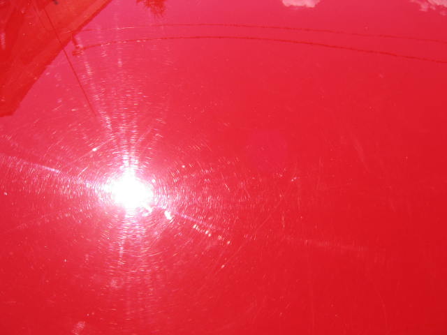

Okay, it's going to take some time and effort but with a dark color like that you can really bring back the shine. Here's how to do it.
A random orbit buffer is the only way to go. These pics are from last summer, I bought the '** the winter before, it’s a 2K. From a distance the paint looks fine, the reds still bright, but when you get up close there are a lot of swirls and fine scratch marks. It looks like someone use a broom to brush the snow off the hood. It also has a few more major scratches. My buffer isn’t a commercial grade, it’s just a $50 Craftsman I got at Sears but it does the job. First I washed with Joy, then clay barred. Next I used Meguiar’s Dual Action Cleaner/Polish #83. If your paint isn't scratched like mine but just has swirls, halo's and haze, use Meguiars Deep Crystal System Step 1 Cleaner. Using the buffer I did the hood three times. You could probably get by with one or two. Then I used the Meguiar’s Deep Crystal System Step 2, Polish twice. I followed that with the NXT wax. Look at the pics and pay attention to the swirls, halo’s, spider webs, and just basic haze that is on the left side compared to the right side. Granted, there are a few scratches that prolly won’t come out without a professional having at it, but I’m very pleased with the results. I’m thinking some #7 Show Car Glaze might give it an even wetter shine. I can't figure out how to label the pics but the third one is the unfinished side, the fourth is the finished side.
