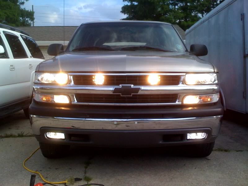

Check out this mod my brother and I just did to his z71:

i like it... any way you could put some pics of how you mounted it and what all is involoved? i have a denali that i had considered hiding fogs behind the grille but havent done it yet....

sure, we have it open right now because we're putting those wire cover things over all the wires, i'll take some pics of the brackets

here you go tribal:
all i did was get some aluminum tubing and cut it out so it only had 2 sides, a back and a bottom, then used self tapping screws to screw it onto the frame that you see in the pic, then i drilled a hole on the bottom of it to mount the actual light onto, except i shaved the bracket thing that came on the bottom of the light so it would sit flat and sturdy onto the metal, then the ground is on the bottom of the bracket under the same bolt

Looks sweet. Do they come on with the stock fog lights or did you have to install a secondary switch for them?

my brother decided to mount a switch for his lights under his dashboard, but when i do mine, i think tomorrow, i'm gunna try to rig it up to come on with the rest of my brights so that it will become a 10 high mod - not sure how im gunna do that though

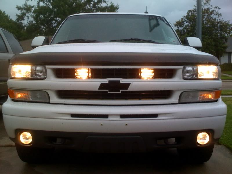

---------- Post added at 06:25 PM ---------- Previous post was at 06:21 PM ----------
just did mine today:

d-max thanks for the pics and the write up... i want to rig something up but i wonder how it would look behind the nali grille?
