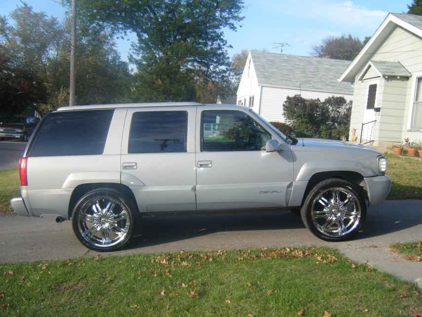

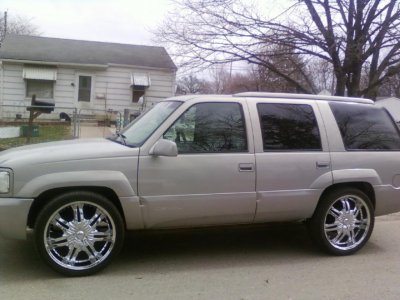

pics inside
hey i need to see a pic. i also have a 99 denali but with a 4/4 w/255/30/22.
Here's a pic that i took with my cell when i got done putting the wheels so the quality of it is bad. The second pic is how it use to be with out the drop.
