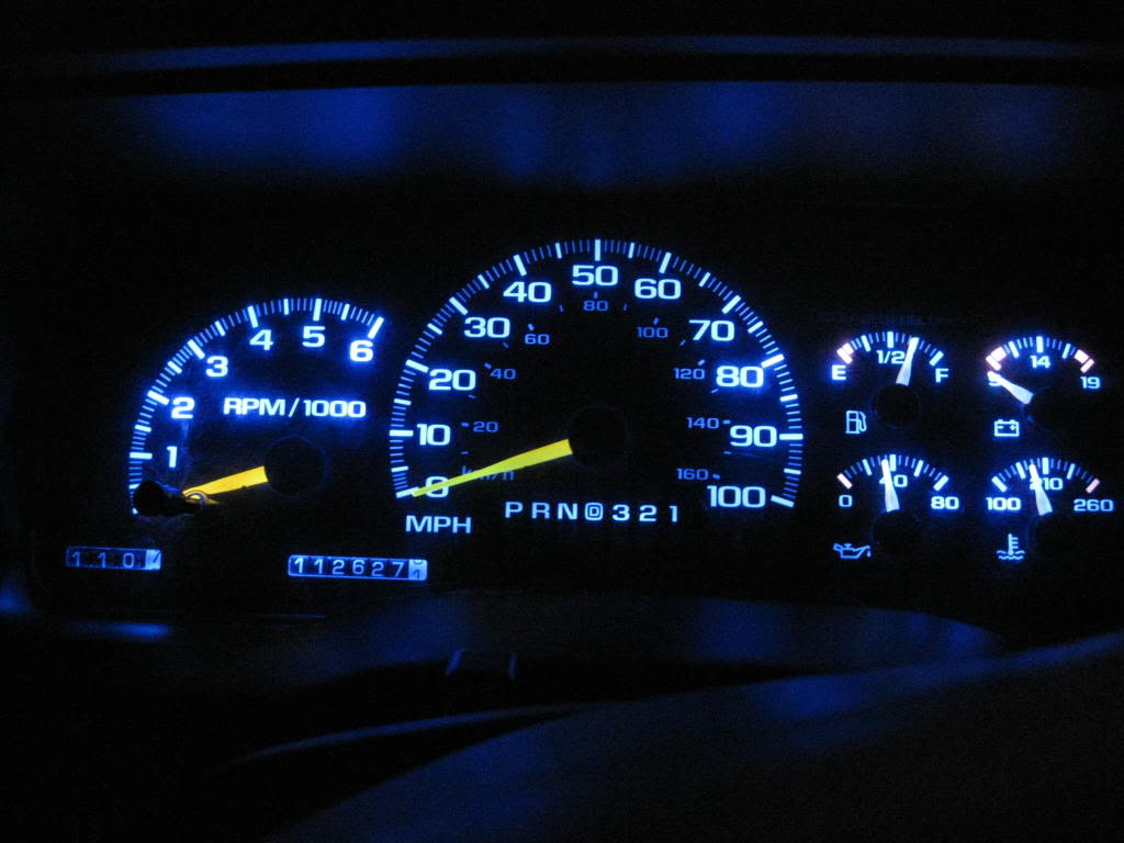

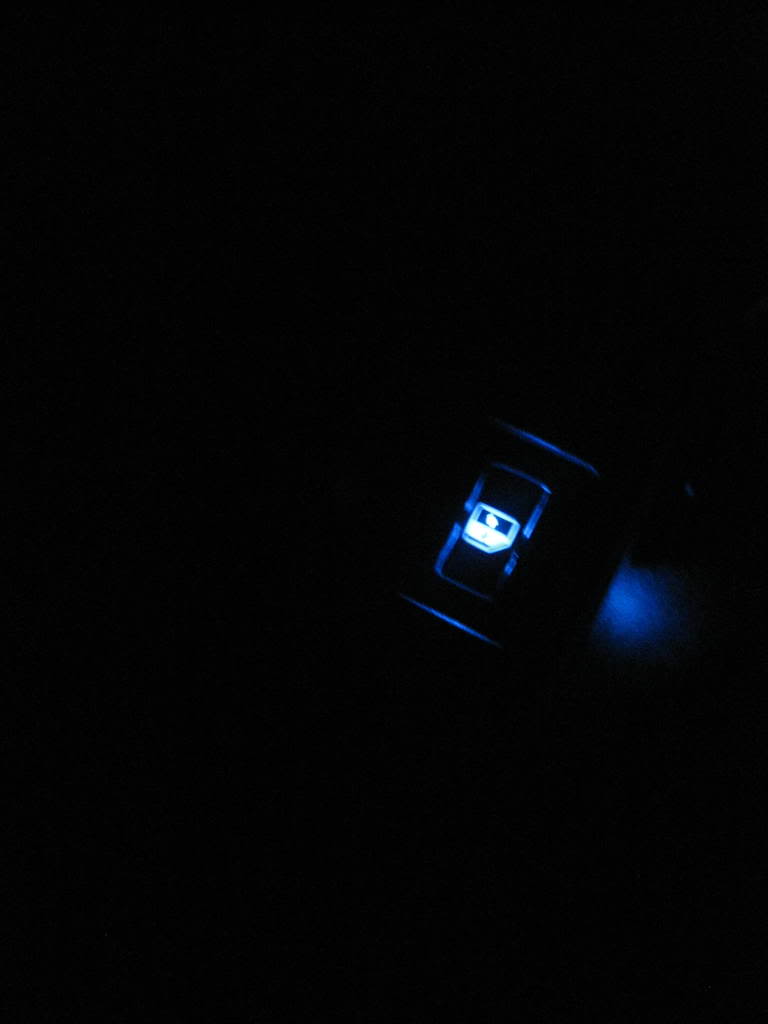

well here they is. lol
dash all blue:

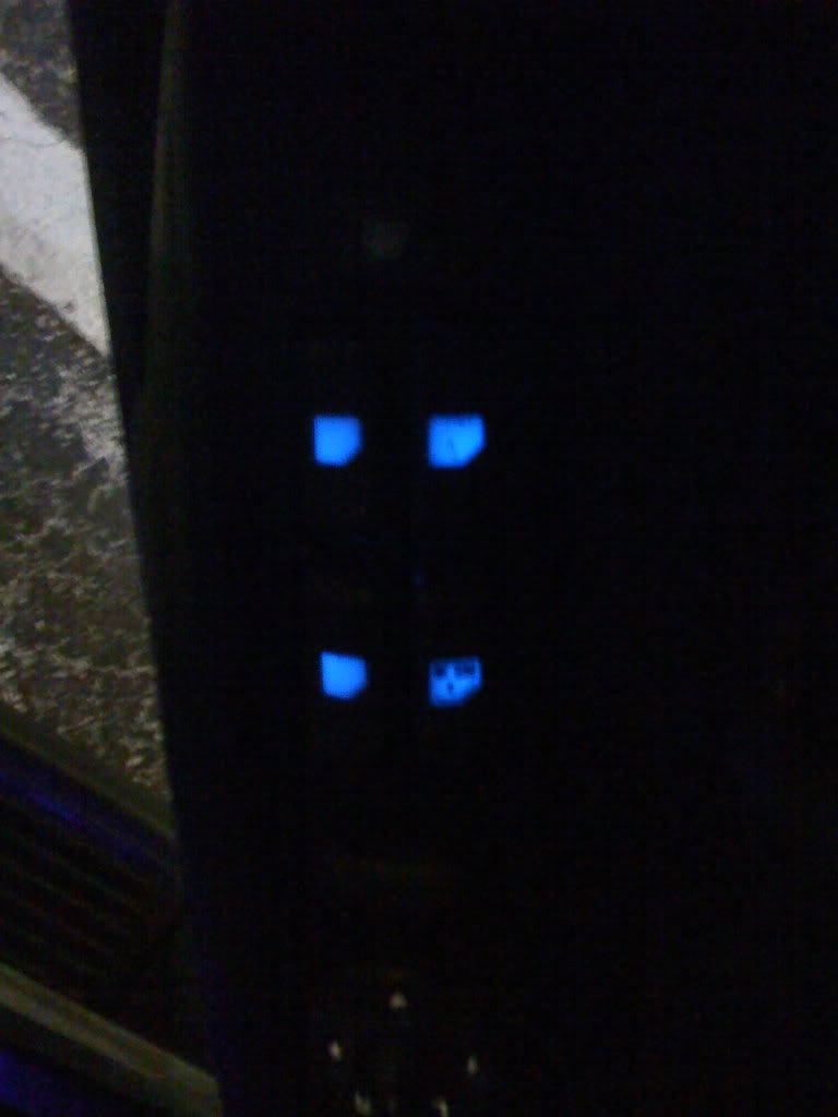

Switches all blue:
dome all blacklights:
someone said to me recently, how do you find anything with these blacklights
my response, make sure what your looking for is WHITE. or turn on the map lights dumbass. lol

Whats wrong with your volt meter gauge??
96ProCompTahoe
Apr 30, 2009
2,606
11
IN
RT- trucks not running so the volt meter is on the bottom.

even if its not running, if the key is on (which it seems to be since all the other gauges work) the volt meter should read the battery volts. Well atleast mine do. I dont recall on the GMT 400s
96ProCompTahoe
Apr 30, 2009
2,606
11
IN
when you shut the truck off the oil, water, and fuel guage don't move for awhile. or thats how it is on mine atleast. all he had to do was turn on the parking lights
