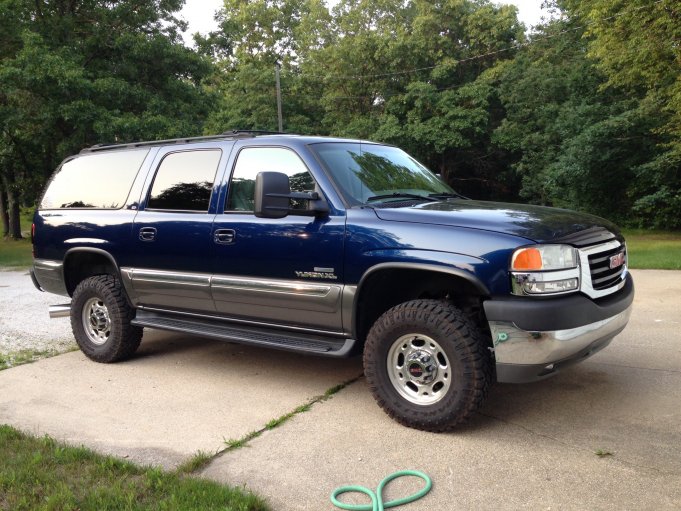

I have about 1000 miles on the duramax and Allison conversion in my 2500 series yukon xl. I also swapped out the rear for the 14 bolt 11.5" full floater rear end. I put a complete BullyDog system on along with 4" exhaust. This thing is unbelievable fast!

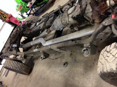

The body coming off
attachment.php
6.0 l and 4l80 coming out

Cant say I have seen someone take pics with the body off the frame. Bet it made the engine swap a heck of a lot easier.

Removing the body is a must for this much work. There was very little that did not get changed in this project. All new shocks were installed, all fuel lines replaced with 1/2" supply line to the diesel, all new exhaust, added 1/2" pickup in the front tank for new diesel pickup, diesel fuel cooler installed, truck radiator, intercooler, transcooler, and condenser all replaced into the suburban chassis, tranny cross member modified to mount to the Allison, AC plumbing modified for the front and rear air conditioning, driveshaft had about 24" removed to fit the Yukon chassis.
We have about 150 hours into the conversion. I think it is well worth it.
I am getting nearly 20mpg and have towed over 10,000lbs with little ease!
