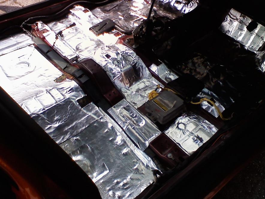

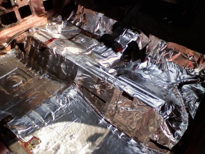

i did my 96 monte carlo the floor and new carpet and i ended up pulling the seats getting them redone and the car sat with no carpet for like 2 months before i finally decided to start cutting the carpet haha, ended up finishing it within 2 days after i started cutting finally, dont know what the hell i was so scared of
heres some pics of my adventure
i want to do my tahoe but not sure if i feel like tearing it apart haha

i hear ya on the fear of cutting. it didn't take long after i got started, but that first cut was hell. from the looks of your pics you feel my pain there. funny the things we'll do huh? let's tear it all apart to put it back together. i was telling my girlfriend that the biggest complement i could have about the whole ordeal is someone asking me what i did, cause it looks stock -- the best you can do is when it looks like you did nothing at all. sucks. all that work and it still looks the same. (my case, similar carpet, etc.)
