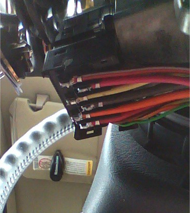

So it appears that they either don't have a diagram or just didn't bother to send me one. I took some pictures of my exposed steering column. Perhaps you can point out what changing part 26049449 actually involves.
